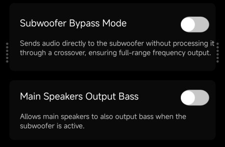

Leave the Amp subwoofer setting on and turn these two switches on.
Both the speaker outputs and the sub output will be full range. Connect a mono amplifier to the sub out and connect it to the wall speakers.
