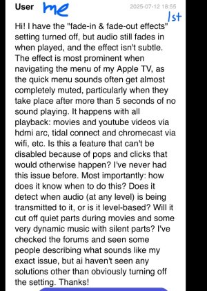

I'm having a very similar (if not the same) issue, and this thread and the one Wiimer linked seem to be the only ones discussing this. I sent the following in a feedback ticket a few days ago but haven't gotten a response:
"Hi! I have the "fade-in & fade-out effects" setting turned off, but audio still fades in when played, and the effect isn't subtle. The effect is most prominent when navigating the menu of my Apple TV, as the quick menu sounds often get almost completely muted, particularly when they take place after more than 1-4 seconds of no sound playing. It happens with all playback: movies and youtube videos via hdmi arc, tidal connect and chromecast via wifi, etc. Is this a feature that can't be disabled because of pops and clicks that would otherwise happen? I've never had this issue before with any other device. Most importantly: how does it know when to mute stuff? Does it detect when audio (at any level) is being transmitted to it, or is it level-based? Will it cut off quiet parts during movies and some very dynamic music with silent parts? I've checked the forums and seen some people describing what sounds like my exact issue, but I haven't seen any possible solutions other than obviously turning off the setting. Thanks!"

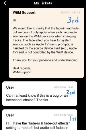

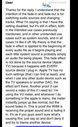

I messaged again to try to get a response, and oh boy I did. A simple "We don't know, we're trying to fix it." would suffice, or "It's an intentional design choice that can't be turned off to prevent users from hearing pops and clicks" would be unfortunate but understandable. However, they...went a different route: (screeshots. hopefully they send in order). I'm biting my tongue and giving them a chance to respond. The company has seemed like a breath of fresh air so far so I'll give them the benefit of the doubt for now.

I figured it out guys, and I'd like to apologize to WIIM. (I will in the feedback ticket too.) After installing the firmware update last night, I tested to see if the fade in was gone, and to my dismay, it wasn't. However, I decided to do some more extensive troubleshooting, to make SURE it was the WIIM's fault by testing different inputs and outputs, and eventually I found out the culprit wasn't the Ultra all along: it was specifically only the optical input of my active bookshelf speakers (not the line input). When outputing optical to another DAC from the WIIM, the fade in is gone, and outputing straight from the tv to my speakers' optical still has the fade in. I'm now using the rca line out from the Ultra to the speakers, and there's no fade in. I did testing before that led me to believe it was the WIIM, but clearly not enough. Thank you guys at WIIM for being patient with me, and I apologize for not testing enough before comming to a conclusion. Thanks for the LP and HP filters in the update, too!
