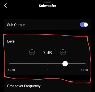

Hi Wilmer,
The volume on my sub is below 50%. I didn't try to increase the volume on the WiiM Amp Pro side: the only way I see to do it is by increasing the level by a few dB. Is this what you ment by "increasing the volume from the Amp" ?
No doubt the the sound I play includes low frequency but I'll do some tests with specific music, because I guess that the subsoofer test I did run does include such low frequencies that might have turned the sub on when I tried.
Thanks for your answer :)
Hi Wilmer,
As @merifon said, turn up the level on the subwoofer setting in the WiiM app while turning down the volume knob on the sub side. Fix it at a position where the auto-standby works properly 🙂
Hi, in fact everything works fine (or almost) if I play a song with a quite high level of bass the subwoofer turns on. If the song doesn't have enough bass, nothing happens until a high bass song is played. I kept the level at default level ( 0dB) because I don't want to increase the subwoofer volume (but I might try soon).
Just to be clear, the target of increasing the subwoofer level in the WiiM Home app is not to have you stand louder bass. :)
Turn the volume knob on the sub further down as you increase the level in the WHA. The overall level shall remain the same. But the auto-sense circuit of the sub sits in front of its volume knob, so it will switch on at lower levels then before.
I think the line input of 610 was designed keeping in mind a full range signal incoming from pre amplifier. In my previous set-up it was turned on even by just the little "thump" noise from powering on the pre. Now I have a dedicated and filtered subwoofer output and it starts only if overall volume is not too low and differently from WiiM solutions, the sub output it's not adjustable. Definitely I have to listen not at quietest level of nocturnal listening. Another parameter that can change the behavior of auto power on, is the cut-off frequency: lower is and more energy is required. I think you should go without fear with level rising on WiiM's output.
