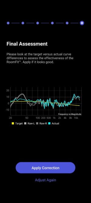

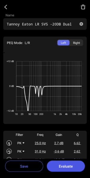

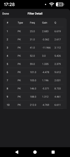

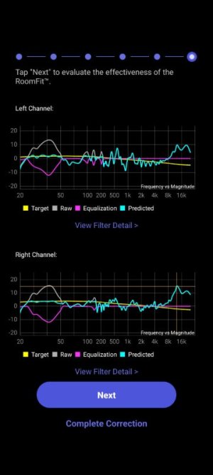

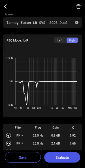

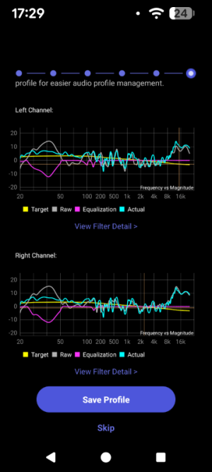

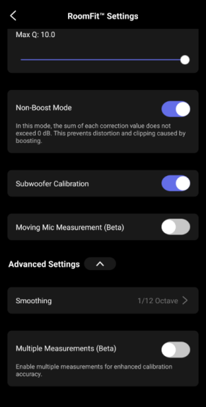

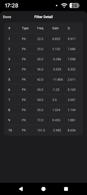

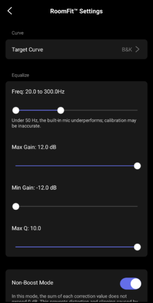

As a last thing to do before I finished for the night was to run a new RoomFit evaluation.
I didn't change anything from what I was running earlier ... that is crossover at 80Hz, phase 180°, Bypass Mode and Output Bass both off. I didn't have time to run a new subwoofer sync so the latency stays the same.
My room has a bass hump around 50Hz and that's still there with the room evaluation and most of the PEQ bands are still used to correct it but not a problem. Here are my results ... next is to have an extended listen when I get the chance 👍
Screenshot_20251211-112607.pngScreenshot_20251211-112634.pngScreenshot_20251210-172552.jpgScreenshot_20251210-172656.jpgScreenshot_20251211-112511.pngScreenshot_20251210-172809.pngScreenshot_20251211-112533.pngScreenshot_20251210-172857.pngScreenshot_20251210-172920.png
That's looking pretty good to me! Good job!

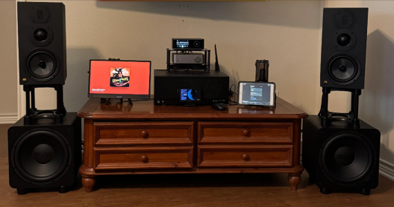

running stereo SB1000Pros and loving it with my Swan 3.1A's setup as virtual 4-way towers, Ultra + Vibelink
as you noticed its not necessarily more bass its better bass ( at least to my ears )

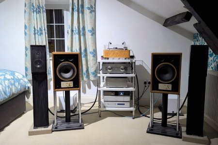

And here's the SVS 3000 Micro's paired with the Tannoy's. Amplification from the WiiM Ultra is the WiiM Vibelink.
Some tracks I think that the bass is too dominant but I've got used to dialing it back with the Ultra. I think that the main improvement has been to give a "fuller" sound whatever that means. When I compare this rig to the Sonus Faber Guarneri driven by 350 watts of MF Tri-vista power the difference in depth of bass when playing the same track is very noticeable as you would expect.
Best of both worlds really as the the MF system is primarily for playing records but it still sounds superb when streaming Amazon Music hd ultra tracks via a ten year old arcam rdac (using a laptop and rwand). By the way the arcam is a great second hand buy if anyone wants to get into a cheap streaming option other than WiiM.
If I can be arsed to fiddle with changing over the subs to that system I might be tempted to see what it might sound like ...
Stone Temple Pilots? Quality! Setup not bad either :)
