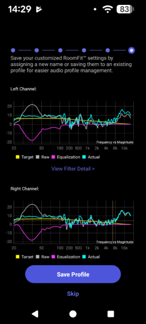

Before I had to go out I was listening to various tracks on the Ultra with RoomFit correction set at -10dB and the SVS volume set at -10dB .... I quite enjoyed the rendering. The bass wasn't overpowering but it was present and it wasn't thud thud thud as I described last evening ... it was well defined in that it had observable layers.
On a couple of tracks I could feel the pressuring of the room ... not in painful to the ears way ... but noticeable all the same.

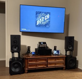

Just a few quick questions ... what made you decide to go with twin subwoofers? Did you start with one and then add a second later or did you go straight to using two? How are they connected to the Ultra? A "y" splitter RCA cable? I think that the Ultra configures both in mono not in stereo ... is that right I'm probably wrong. Interested because I had thought of buying two Micro's but decided I needed to walk before I tried to run 👍
I had the first SB1000Pro when I built the Swan 3.1A speakers and had them powered by an old Pioneer AVR which didnt have enough power to work the Swans effectively so I started my quest for a new pre-amp/amp when I decided to get the Ultra + Vibelink the last Amazon Deal Days sale, the results were spectacular so in my quest to optimize what I had started to research multiple subs and decided to pick up a second SB1000Pro which is when I stumbled upon this informal yet advanced room-fit guide, I picked up a Dayton Audio iMM-6C microphone and started tuning and the results are quite amazing, thanks again

Having multiple subs gives you a chance to get similar bass quality accross multiple listening locations, especially if you run optimizations with MSO (Multi Sub Optimizer) software.

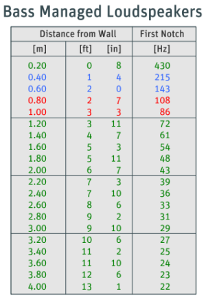

Actually, Neumann provides different recommendations for bass-managed loudspeaker (i.e. loudspeaker + sub) compared to recommedations for fullrange loudspeakers (which is the one you posted).
Here's how bass-managed placement recommendations by Neumann look (link to source, search for "Loudspeaker-Boundary Location" file):
When using subwoofers (and bass management) you should refer to this table when placing speakers, not the other one. Note that ~80Hz crossover is assumed here, and subwoofer(s) should always remain close to walls.
The placement recommendations for fullrange speakers vs loudspeakers+subs are different because in a bass-managed system you can place subwoofers at different places compared to loudspeakers, allowing you to use the crossover to avoid SBIR dips in cases where it simply wouldn't be possible with integrated fullrange loudspeakers.
I.e., using subs gives you significantly more flexibility in placement.

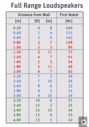

The first consideration is the room: what is its acoustic behaviour and which main speakers should be used for matching?
Neumann is designed for professional use, and the woofers are usually not located on the axis of the main loudspeaker, which is why the woofer table and the setup shown above are close to the wall on a more or less vertical axis.
If the RT60 is reduced from 200 Hz to 100 Hz to just 300 ms, the effect is astonishing. If you manage to stay in the range of 400 ms from 100 Hz to 50 Hz, the bass/upper bass performance is completely different.
I know that there is a table for woofers.
However, the distance calculations for LS systems in the link I provided are slightly different.
The aim here is to avoid TT room mode excitation AND define initial reflections in the room.
I have implemented the distances "calculated" in the link, as well as those propagated by Neumann, with various woofer & radiation principles, including the DSP 750 woofer from Neumann.

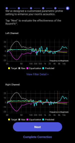

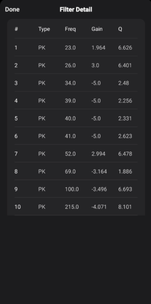

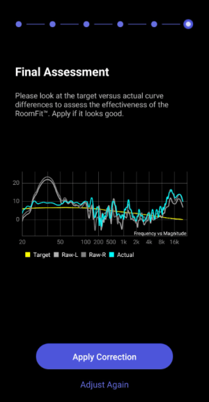

So .... I reran RoomFit but within a narrower min/max range of -5/+5dB gain. Results were very similar to before with a hump at 40Hz and all the PEQ bands being used to smooth out the response. Unfortunately I don't think I will be able to get rid of this as it is because of the room setup.
I could try moving the subwoofer to a different position but who knows what would happen ... it's currently sat behind the right hand main close to outerwall boundary's as SVS tend to recommend.
If anything, you should rather increase the min/max range per PEQ Band to the lowest/highest possible value of -12 dB/+12 dB, not decrease it (as I said before).:)
The idea behind this is that less PEQ filters need to be combined to get a 20 dB reduction.
Also, let me try to rephrase my other recommendation one more time: Before we can agree on which is the best subwoofer level setting you have to make sure that the main speakers' and the subwoofer's output add up as much as possible right at the crossover frequency.
The phase difference between the speakers and sub need to be minimised. In other words: The peaks of the sound waves from mains and sub should reach your ear at exactly the same time (in particular at the crossover frequency). There shouldn't be any acoustic delay to either signal.
Changing the min/max gain to ±5dB can't solve the issue, so these results are expected. Actually, using ±5dB makes it worse, because more of the PEQ bands need to be assigned to the 40Hz resonance to bring it down. So I'd suggest to keep RoomFit min/max gain at ±12dB.

Let me clarify that I don't believe there's that much need for correction above 100Hz in your system anyway.
Actually, after correction your response looks very good already.
The intention is just to see if you can improve subwoofer integration any further.
IMHO there's no need to consider a second sub, at least not because of this.

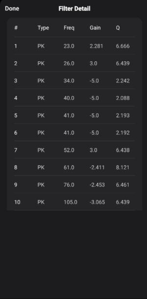

Ok ... I misunderstood.
My original results were based on min/max -12/+12dB.
The 7ms difference between main and sub was measured by the Ultra positioned in my listening position. That's with the sub physically 2ft or 60cms behind the mains. I can't really move the subwoofer into the same plain as the mains ... there will always be a delay that is measured and corrected by the Ultra.
Overall the sound is pleasing especially when I add a touch of EQ to it ... maybe I will stop here but then again I have time on my side to trial other things and who knows I may return to where I am right now. The good thing is that the Ultra allows me to store each attempt with a different name that I can compare and contrast ... an incredible bit of kit for little money.

That hump at 40Hz is bothering me but seemingly not anyone else? I believe it's a room and sub positioning issue and that maybe a second sub placed mid room would smooth out the room effects.
