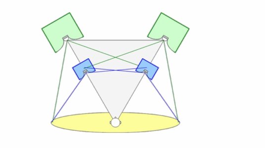

A DBA that places the woofers diametrically, meaning the rear wall of the LS or the rear wall of the listening position, and don't forget RT60 ~ 4 ms.

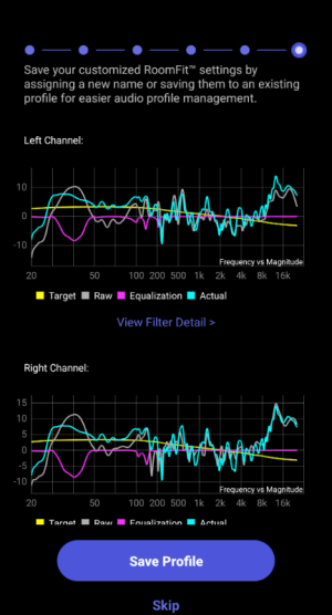

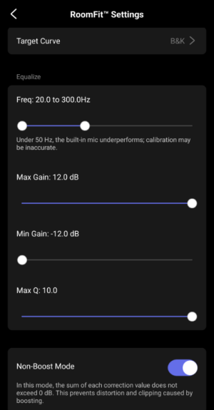

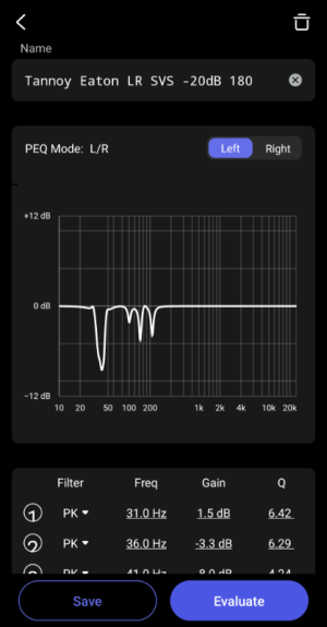

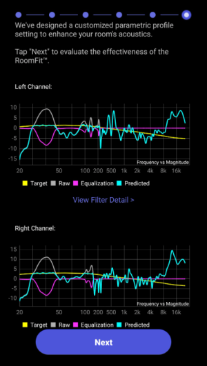

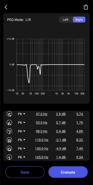

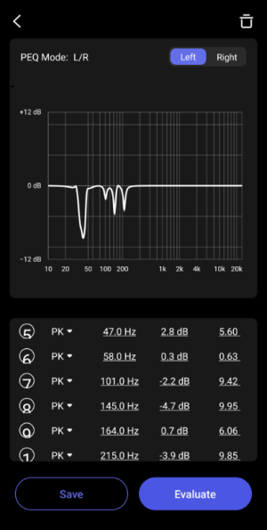

I ran @dominikz option 2 with the SVS set to -20dB and 0 phase and the Ulta at 180 phase. Couldn't be arsed to move the Ultra to my actual listening position, to run the sub sync function, as it's not far off anyway. I ran the sub sync function first again at 0 phase on the Ultra. The result was pretty much the same as before at 9ms. I then ran the sub sync function at 180 phase and this time the delay was greater at 13ms ... not sure why this should be?
Anyhow I proceeded to run RoomFit at this setting and at -12/+12 gain.
Here's the results:
Screenshot_20251119-124253.pngScreenshot_20251119-124202.pngScreenshot_20251119-124530.pngScreenshot_20251119-124745~2.pngScreenshot_20251119-124914~2.png
Forgot to take screenshots of the actual PEQ bands sadly.
Profile saved and now listening to the Ultra which honestly sounds good to these old ears 😊

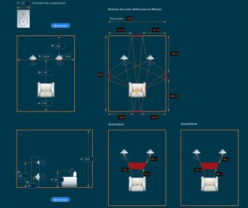

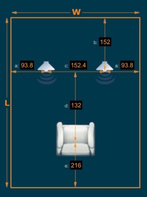

An example of the necessary preparatory work
Room 5 m x 3.4 width x 250 height = 42.5 m³
However, clipping is only lifted to the extent that the playback chain provides the corresponding levels.
My2 Cent A DBA is best

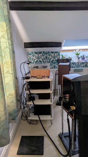

Thanks for these suggestions however I'm really fixed with my current positions as they are in a bedroom ... not ideal but it is what it is and I have to work with what I've got unfortunately.

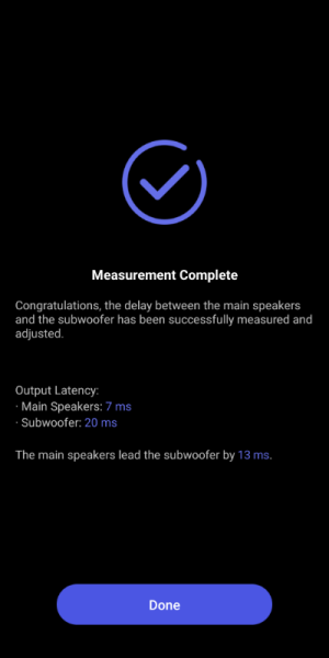

My point is that you can manually change the latency between the main speakers and the subwoofer without physically relocating any of them and without having to carry the WiiM Ultra around.
The reasoning is that the automatic sync might still not give the perfect result, even if you place the Ultra in your MLP.
There's no guarantee, it's just an additional degree of freedom you can make use of. Running the RoomFit procedure and/or evaluating a RoomFit profile (the latter is restricted to stereo mode results) might be a bit cumbersome, but it's not half as tedious as moving speakers, subs or the WiiM Ultra around.
Again, it could be that there is not much to gain (I didn't try to analyse your latest results yet) but changing the latency in 1 ms or 2 ms steps is free and easy.
Again, it could be that there is not much to gain (I didn't btry to analyse your latest results yet) but changing the latency in 1 ms or 2 ms steps is free and easy.
Ok I get that I think
So if the Ultra's measured the latency as 13ms then I manually adjust it down to 11ms with the current configuration, then maybe 9ms, 8ms, 7ms and so on running RoomFit again after each and observe the results.

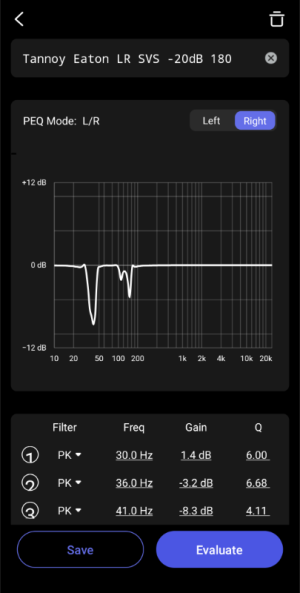

Anyhow ... any opinions on the change to 180 phase results? Certainly the PEQ bands are reaching beyond 100Hz now ... not so many needed to smooth out results below 100Hz.
Told you so .... Knew there would be like minded people on here 😉
The latest results show the response below 50Hz is up to 5dB above the target curve. Why would that be?

So I'm into experimental mode now before I have to take a break.
Here's the results:
View attachment 29683View attachment 29684View attachment 29685View attachment 29686View attachment 29687
Great work!

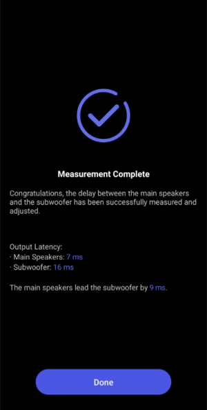

I'd say this new attempt shows that your original calibration with subwoofer level at -10dB, phase at 0°, and 9ms delay for the speakers is the way to go.
The delay value of 9ms is IMHO more reasonable than 13ms. You get a higher delay value with phase set to 180° because the system is trying to compensate for the phase mismatch between the speakers and the sub at the crossover.
Note that SVS sub DSP adds about 6ms and the difference in speaker/sub distance should add 2-3ms more which comes around 8-9ms total - which is just what you get with phase set to 0°.
So this is the setup and calibration I believe you should return to:
If you want to continue experimenting (not that there's really a need for it), what you could try to do next is:
  • Try to increase the crossover to e.g. 100Hz. Re-run sub sync function and re-run RoomFit and compare vs the crossover at 80Hz. The idea here is to see if the response between 50-100Hz changes much with a different crossover point.
  • Try a few alternative positions for the sub. I'd suggest to try both front corners (right in the corner, against both walls), and against the wall between the speakers. At each position re-run sub sync function and re-run RoomFit. The intention here is to see if any other position decreases the 40Hz resonance somewhat.
With any of these variants the intention is just to see if the response pre-RoomFit can be improved.
The response after RoomFit should look similar to what you get already at your current positions with subwoofer level at -10dB, phase at 0°, and 9ms delay for the speakers - there should be no dips/cancellations.
This is why I say it is not really necessary to continue experimenting - so I'd suggest to only do it only if you find the experimentation interesting. If not, just sit back and enjoy the music! :)
