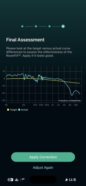

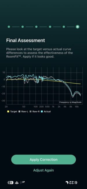

Here are my measurements with the calibrated microphone.

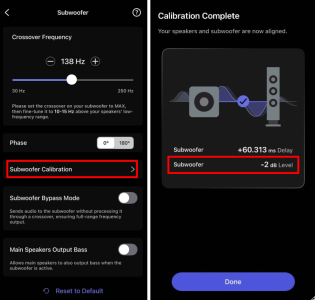

The image below is a screenshot used in a subwoofer related document titled "Subwoofer Calibration: One-Tap Sync between Main Speakers and Subwoofer at the Listening Position", which is posted on April 15, 2026.
Source: https://faq.wiimhome.com/en/support...akers-and-subwoofer-at-the-listening-position
The red box area looks different from the UI of the WiiM Home App I’m currently running. Do you guys also see the same UI as the one shown in the posted document?
The subwoofer level is a new feature only available with new firmware presumably.
