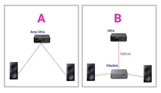

Can I bridge the vibelink and amp ultra?
(No, that's not a serious question.)

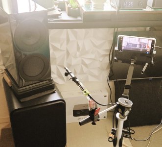

I made a comparison video.
(Do some of you like this kind of thing?).
Amp Ultra vs Ultra + Vibelink Amp
EQ off, no Sub, mono recording.
Either blue or green is the WiiM Amp Ultra. If you are interested, play it on your WiiM using GoogleCast or Bluetooth.
#A video made by an very amateur using an IMM-6C microphone and an Android phone. I hope you enjoy it and please don't take it too seriously

From shooting scene..
Thank you![]()
Agreed.Very difficult and academic to evaluate anything like this, as we are listening through a filtered recording system, imposing its characteristics on the original sources.
In any case, I listened to the recordings using a pretty high end dedicated headphone amplifier and a 4 figures known classic open-design headphones set (known to be vey neutral). My impression is that the first system (neutral gray screen) seems to sound somewhat more effortless and the other system (green screen) sounds more constrained,

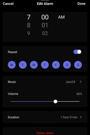

What I can tell you straight away: It does work with the WiiM Amp and the WiiM Amp Pro. I have no reason to think it wouldn't with the WiiM Amp Ultra, since the software is basically identical.I want to ask the owners of WIIM AMP ULTRA for one favor. Can you please try setting the alarm, for example, to 7:00 on weekdays, the alarm sound source - Tune In and set the playback duration when waking up to 60 minutes? This is an important functionality for me, I want to wake up in the morning with music and relax in bed for an hour.
Thank you.
Yes, like @harkpabst, I have tested alarms too. And I was able to play the Tune In.I want to ask the owners of WIIM AMP ULTRA for one favor. Can you please try setting the alarm, for example, to 7:00 on weekdays, the alarm sound source - Tune In and set the playback duration when waking up to 60 minutes? This is an important functionality for me, I want to wake up in the morning with music and relax in bed for an hour.
Thank you.

The M-CR612 used to be a bargain, given it's flexibility and sound quality. I did recommend it to friends and family in the past. But honestly, if you don't absolutely need the built-in CD drive, the WiiM Amp Ultra is in an entirely different league! This is not an exaggeration, I really mean it. It's the much more modern device, much easier in daily use ... and better sounding.I originally wanted to buy a Marantz m-cr612, but it can't turn itself off after the alarm.
I believe you, and I performed my WiiM amp setup exactly according to the manual. The manuals exist for a reason, you may or may not follow it, but then if something goes wrong, then those users are so quick to complain.You would think that but it is not always the case. But no problem if you guys don't believe me, I tried....
I have one more question. Can the Wiim Amp Ultra play Tunein stations without the app? As I asked, I would like to use it as a clock radio in the bedroom with just the remote control.What I can tell you straight away: It does work with the WiiM Amp and the WiiM Amp Pro. I have no reason to think it wouldn't with the WiiM Amp Ultra, since the software is basically identical.
I also just tested a single, non-repeating alarm set to 5:29 pm, running Radio Paradise Rock Mix (stored as a preset in my case) for 3 minutes. As expected, it worked just the same as with the other WiiM Amps.
Sorry I'm not @harkpabst, but yes, you can. If you registered Tunein as a preset, it can be play back simply by pressing the preset button on the remote.I have one more question. Can the Wiim Amp Ultra play Tunein stations without the app? As I asked, I would like to use it as a clock radio in the bedroom with just the remote control.
You may assign radio stations to the Presets and then use that for alarms, the screen and the remote. You will however need the app to set it up.I have one more question. Can the Wiim Amp Ultra play Tunein stations without the app? As I asked, I would like to use it as a clock radio in the bedroom with just the remote control.
