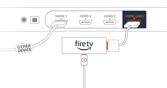

If possible, can you connect your fire tv stick and satellite box to the tv and the use the tv’s hdmi arc connection into the WiiM? It’s essential that the tv has an hdmi arc connection otherwise you can’t use hdmi with your Amp Ultra and may need to fall back on optical if your tv has such an output. That might make management of the other devices a bit more difficult.
There’s unfortunately no easy way of integrating the WiiM with the Logitech harmony remote itself, but you should be able to use auto sensing of the hdmi input on the WiiM for it to switch to the tv connection, while the harmony remote takes care of the other devices. I would add one caveat and possible barrier in that it’s generally advised not to use HDMI CEC on devices controlled with a harmony hub remote as it can lose track of the state of interconnections and mess up the harmony activities.
