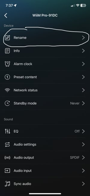

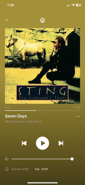

As of my last post I went ahead and Factory Reset the Pro for the sake of troubleshooting, and went through the setup process again. Worthy of mention is that the SSID setting (Rename) is available again, and when using Airplay the Home App now shows the artwork from the song that is being played from Apple Music which the app did not do before.
I will continue to monitor the Pro behaviour and any Home App changes.

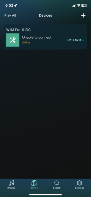

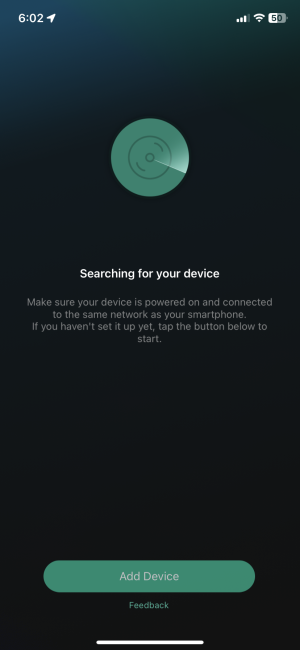

Hello Again, it has now been less than a week since my last report that my Pro has become disconnected from the Home App and cannot be reconnected unless I unplug the unit and power it on manually. I’m beginning to wonder if I just have a bad unit?
I have followed all suggestions including restoring the unit to factory settings. The unit has the latest firmware, and I have even assigned the unit a reserved IP Address on my router. I also have the unit set to never go
