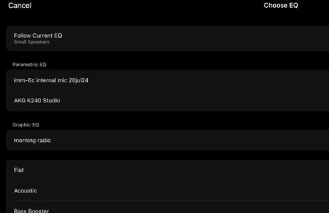

….if only there was an option to switch easily between different EQ settings (call it what you want) - that was very possible with PRESETS and is not possible anymore. not to mention the latest remote update, easily enabled switching between 8 presets using the remote (double clicking a button).
That’s still the same as far as I can see - what you can’t do yet is change Roomfit profile in a smart preset, but you certainly can change EQ/PEQ viz .
seriously, in order to change between RoomFit profiles I need to
unlock my phone
enter the WiiM app
go into the device i'm listening to settings
go into RoomFit settings
change EQ profile
BEFORE:
click a button on the remote
honestly, stop looking for "use case workarounds" and how "you're not getting this update right" -
this "upgrade" should not have been released the way it did. to the point where WiiM support team asks me if I want to downgrade my device

Perhaps if you were clearer in what you initially said you couldn’t do (“if only there was an option to switch easily between different EQ settings”) and read my response where I says you can change EQ settings in a preset but not yet roomfit profiles, there would have been less confusion. At least your most recent response was less ambiguous. I do agree that the ability to change roomfit profiles should be possible in smart presets and have already submitted a feature request ticket for it, but I guess a lot of people will have just one roomfit profile so WiiM decided to release the update as is rather than delay it any further while it added that further feature.
