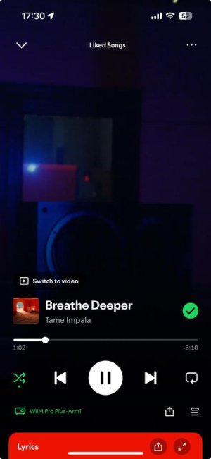

Hi ,
I have bought the Wiim Pro Plus to connect it to Wiim Amp for the better DAC. LINE Out ( RCA ) from Wiim Pro Plus to Line IN(RCA) to Wiim Amp. When i stream music from Spotify and try to apply an EQ ( preset ) or Custom it doesnt change the music sound at all. Can someone enlight me on this ? When I was playing music thru Wiim AMP Only the EQ worked.
Best regards,
Andrei

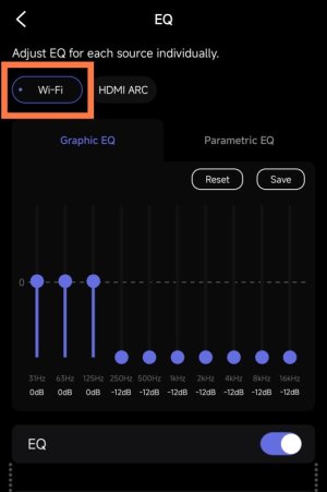

If you still just want to know what's going on (which I could understand), @Wiimer proposed pretty much what is possible.
The most important thing is that EQ can be different per input, but @Wiimer had that covered, too.
