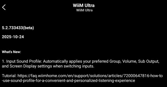

I think you'll need to wait for the "Input Sound Profile" feature to become available for the amp ultra.
It's currently in beta testing for the Ultra.
To easily get to the tutorial, select Wiim Support on the menu bar at the top of this site then search for sound profile; should be the first hit.

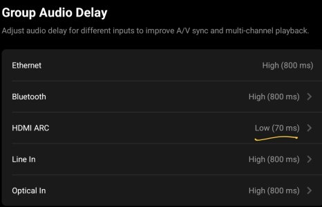

@Tictac This can be partly remediated by reducing the group audio delay for hdmi input to 70ms.
Audio Input, Group Audio Delay menu.
Best to dismantle the group though for hdmi and use it again for music, for now..
