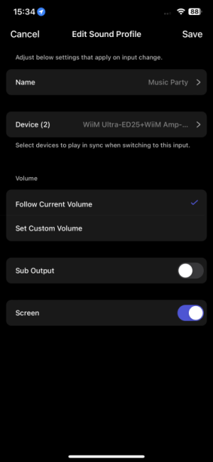

The Ultra's Input Sound Profile beta already includes the ability to turn off the screen via HDMI input.
