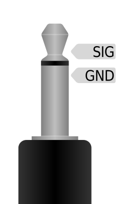

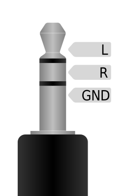

I'm with @Wiimer here, two stereo cables (with one channel unused on the RCA side) are probably your best bet. Also,.you should probably set each speaker to Mono mode.
A mono (TS) plug inserted into a stereo socket (made for TRS plugs) will short the right channel at the speaker's input.
Usually not a good idea.
According to the manual there's no way.to connect two of these speakers via Ethernet cable.
View attachment 35111 View attachment 35112
