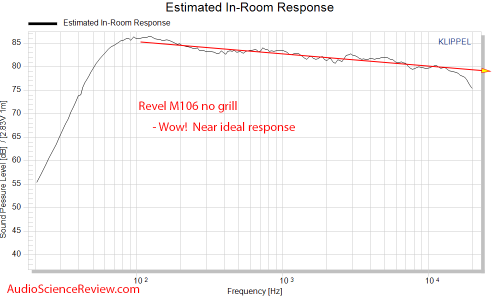

Load dependency changed FR by +/-1dB. Below 10 kHz there’s very little deviation above +/- 0.5dB.
The very (very, very, audiophile, 4-figure, very, very) best accurate and flat frequency response speakers I’ve seen reviewed have FR deviations of +/- 1dB.
This is a £300 streamer, DAC, PEQ, amp.
