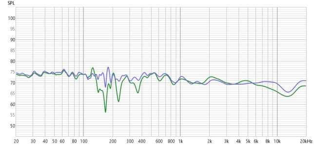

I may have discovered a long-requested feature: 20 filters to use with Room Fit. Here's what I did:
1) I performed a Room Correction using House Curve, which allows up to 20 filters using all 20 of them.
2) Once I had the correction for the 20 frequencies, I manually copied 10 values into Room Fit and 10 values into GEQ.
3) When listening, I use Room Fit with the GEQ overlay, effectively using 20 filters.
