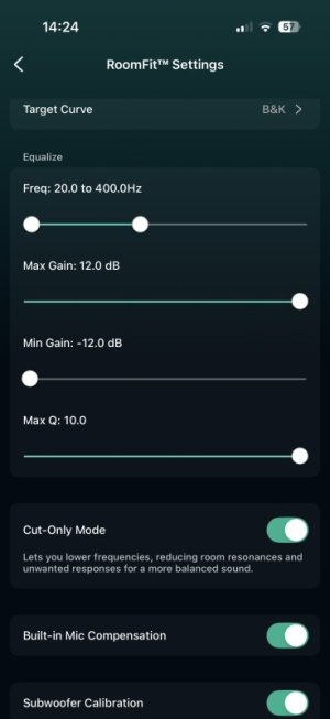

Thanks, yes I also decided to go for 40-300hz instead of higher, along with +3db/-12db, Max Q 10, Cut-Only mode enabled, 1/12 Octave, individual-channel correction - and personally I prefer flat curve, I realize most people disagree, but maybe it's because my Dynaudio Special 40 + Audia Flight combo is rather laid back and never harsh, so I never feel the higher frequencies are overempahsized when using flat curve, to me it sounds just right

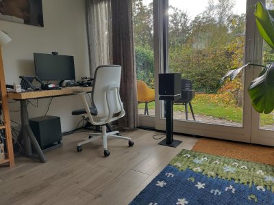

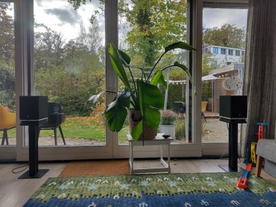

@dominikz @harkpabst Thanks for your responses! I've attached two pictures of my speaker setup in front of the sliding doors and of where my subwoofer is at the moment. The speakers need to stay on that side of the room but the sub has a 10m cable connected, so that can basically go anywhere. I used to have the sub on the right, where your can see the Hotwheels track, but moved it to the other side of the room to see the effect.

So what would your advice be on positioning them? The pictures were taken from my listening position, by the way. Oh, and would you recommend putting the stand on the spikes they came with or not? The floor is ceramic tiles on concrete.

Let's start with a few questions:
  • How far from adjecant side walls are your speakers at the moment?
  • How far away from the glass door would you be willing to push the speakers?
  • Could you put the sub in a room corner, next to one of the speakers?
  • Do you have any frequency response screenshots from RoomFit for your current placement?

- About 1.5 metres.
- As far as necessary but the desk chair running into a speaker is a bit of a risk.
- Definitely, it can go anywhere.

OK, that’s good. As a first step I'd suggest to keep them where they are and run RoomFit. Do you have a calibrated measurement microphone like UMIK-1 or IMM-6c that you can use, by any chance?
Great, I'd recommend a front corner position to start. Either one.

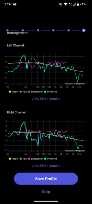

@dominikz Here's the screenshot of my measurements. I pointed the mic at each speaker and the sub is now postioned in the left corner of the room. I use an iMM-6c for the measurements.
