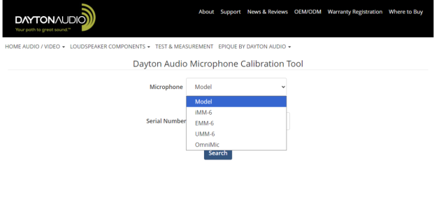

Selecting iMM6 in the dropdown is for both iMM6 and iMM6c. I don't know why but that's how it is.
