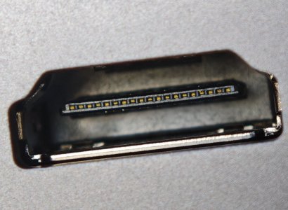

Please take a photo of the HDMI port to check for pin damage or foreign objects. This is the HDMI port on my Amp Ultra. Mine does not have that issue.
