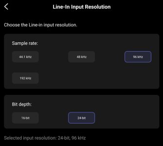

Have you already tried switching the Pro's line-in resolution?

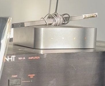

Is that a TV aerial cable on top of the Pro?
Have you already tried moving the Pro to a different location and changing the power adapter (charging adapter)?
No, that’s a Nintendo Wii IR receiver. I am using a Sony. STRDH-790. I have tried changing around the resolution. I believe I’ve tried it in every resolution configuration and still I’m having the issue. I will try the headphone. Port in a little bit.
