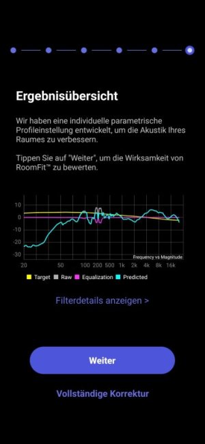

What settings did you use for Roomfit? Do you have a USB microphone.
No USB microphone, just Android smartphone, not quite ideal, I know.
I will dive deeper into roomfitting now, maybe I can organize a real microphone as well. I will not give up, thanks a lot 👍
Yes. Try with a proper calibrated USB mic. The Android phone microphones usually only makes it worse.

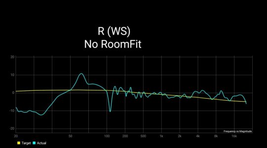

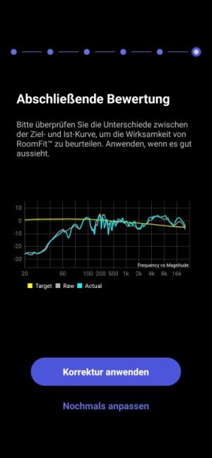

Could you post a screenshot of the final Roomfit results?
This is the raw response of the WiiM Sound (WS) placed in my bedroom. The WS is positioned 30cm away from the wall, and the listening distance is 2.2m.
Like you, when I first heard the WS's sound, I felt the bass was boomy and the overall balance was off. Of course, this varies depending on room conditions, placement, listening distance, etc. However, if you get a similar response from your WS, I think simply suppressing the peak around 70Hz could potentially reduce the boomy bass.
(I think you can find this bass peak even with the phone's built-in microphone.)
For the mid-to-high frequencies, you might want to try the speaker EQ settings @dominikz recommends. (I'd be happy if @dominikz could offer some advice later.)

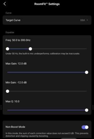

@Chris1974
Set the same values in the RoomFit settings screen and run RoomFit.

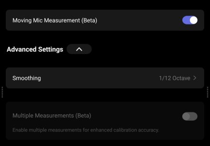

When Moving Mic Measurement (MMM) is enabled, pink noise will play for 30 seconds during measurement. Slowly move the phone around the listening position (within a sphere of 60cm to 1m). Ensure there are no obstacles between the phone and the speaker during this time.
Also, since MMM is prone to picking up room noise, increase the volume slightly above your usual level and ensure there is no noise from air conditioners, refrigerators, or similar sources.

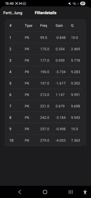

@Chris1974 Once you first run RoomFit as @Wiimer suggested (which should take care of the boominess), you can add on top of that these PEQs in "EQ" menu to address mid and high frequencies (note that RoomFit and EQ can be used at the same time - see this FAQ article):
1000075447-jpg.28782
Bands #3 and #4 are intended to address the IMO excessive brightness.
Bands #1 and #2 are meant to bring back some presence to the midrange (e.g vocals and guitars) - mainly to counteract what I perceive as an upper-midrange scoop in the stock tuning.
There's unfortunately not much we can do about the lack of envelopment/immersion, but hopefully these tonality fixes will help improve your experience a bit!
