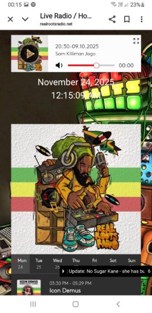

realrootsradio.net (reggae) is not in the Tune-in database or other radio catalogs it seems. They have not published a streaming URL which you need in order to connect via Open Network Stream in the WiiM Home app. There only is a player on their website, if you are a chrome browser users you can Google Cast (Chromecast) it to your WiiM but it would offcource be nice to do it stand alone on the WiiM. Maybe ask them to provide you with a streaming URL.
You have found one of the very few radio stations that seem to only provide their programs via a website. ;)
Thank you, this is indeed the station I'm trying to stream, I've had this unit 4 days, I'm a total 65 year old newbie and seem to have broken the toy/matrix 😬😁😂

There appears to be more than one Real Roots Radio station. No idea which one the OP wants.

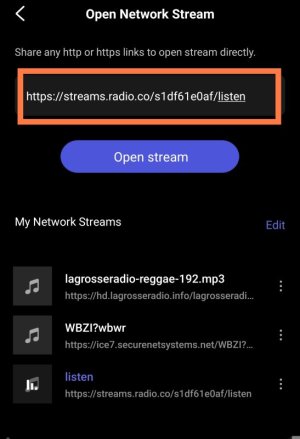

Hi d4ves. Try going to 'Open Network Stream' in the Wiim Home app and pasting in the url below:
And then add the preset as Wiimer mentioned earlier in the thread by clicking on the three dots on the now playing screen on the Wiim Home App to add it as a preset. Hope that helps!

I tend to use the Developer Tools menu in Chrome to find URLs - it launches a separate window which displays activity on the page.
I select the Media tab, then press play to stream the station and note the URL that's playing. It's 99% reliable but doesn't work for certain streams/sites (Apple Radio for one).

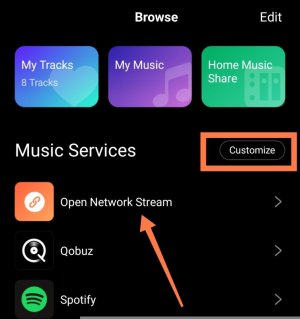

Open Network Stream can be found in the Music Services section of the Browse menu. If it is not present, tap the customisation icon and enable Open Network Stream.
Then paste the URL @Radio Guy gave you into this screen and tap the "Open stream" button to play the radio.🙂📻
Bloody hell!! I'm streaming real roots radio and it's now linked as a preset!! Bonkers!!! Dont know how you did that or how to replicate it for other sites!? I only hope you good people try this link too and enjoy some serious roots music 😉 thank you x......also the unit turned on automatically without being searched for when i opened the app which I'm hoping it'll do regularly but don't want to get ahead of myself 😬😂
