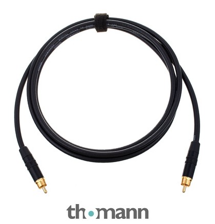

In my system, a Wiim pro is connected to B&O Beolabs 50 active speakers through Coaxial via a 75 Ohms cable.
Wiim is hard wired to the network hosting the NAS.
B&O tech support confirms that the speakers Coaxial input supports 192/24 bitate (the Optical one limited to 96 kHz).
When I play a 192 kHz file with the Wiim, at the 192/24 setting, no sound at all.
If I change the Wiim settings to 96/24, it works flawless.
I have the same problem with Qobuz as well.
I contacted Wiim which diagnosed a defective unit and replaced it.
With the new unit, it's OK with a 2 meters cable but with a 5 meters one the problem appears again... and i have to place the Wiim 5 meters away from the speakers.
Any hint?
Kind regards,
Yann.

Do you have access to any other sources that can feed a 192/24 digital stream via coax, with which you could test your two cables (and any others you may have at your disposal)? I don't know whether an impedance mismatch would be the root cause of what you're observing, but clearly something is interfering with the signal along its path between the streamer and the DAC circuitry.

The cable are Cordial CPDS, 2 and 5 meters versions
