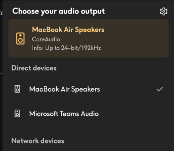

So, after a recent initial firmware upgrade weeks back that required a reboot, still seeing that weird reliance where the Qobuz desktop version on Mac OS is required to be active for the IOS devices to connect.
Without it, the IOS devices will spin six times attempting to connect to QC and then revert.
Have done a complete reset and updated firmware but the odd reliance on the desktop Qobuz application being on and set to Qobuz Connect continues. The beta version didn't even have that issue.
If the Qobuz desktop application is on and set to QC it will "slip" back to the Macbook Air local speakers in about 15 minutes. Without the desktop Qobuz app, there would be no way for the IOS apps to link up with QC. I've tried numerous approaches and noticed that when the Qobuz desktop is open without use it will "slip" back to the local computer speakers. The IOS devices then can't reconnect to QC by themselves.

Have you thought about posting about this on the Qobuz Club forum?
Yes, but unsure what is the origination of the issue. It occurred after an earlier WiiM firmware upgrade didn't take cleanly. So, I had to do an additional reboot and that's when it began. I may drop an email to Qobuz @ support-help@qobuz.com as they are pretty good at looking into issues.
Since QC was working great earlier, not even sure where the problem originates. Such an oddity.
