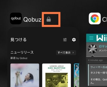

Try locking the Qobuz app in the task screen.
The music will not stop unless only the Qobuz app is directly killed.
And in this case what @Wiimer said is the easy solution. (y)
