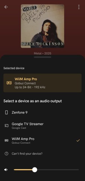

You close which app here?But why stops my WiiM playing from Qobuz Connect when I clos the app on my Android Phone?
That's kind of odd, though. On my iDevices, I can use Qobuz Connect in the native Qobuz apps to play music to my WiiM Ultra via Qobuz Connect and if I close that native app on my iDevice, the music doesn't stop.You close which app here?
To use Qoboz Connect you must initiate the playback from the Qobuz app on your phone. If the music stops when you shut down "the app" then you can be sure that you're not using Qobuz Connect.![]()
Right. He’s likely using Google Cast and that can lose the connection if the WHA is not opened and checked the playback page.You close which app here?

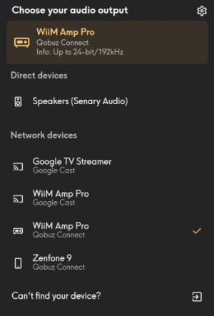

Wait, you say you're casting from the Qobuz app on your comp and the music is playing on your WiiM. But as soon as you kill all background apps on your foon the music stops?Only got one option on my foon.
In the windows app I have also the Google Cast option but it is connected to Qobuz connect now.
And again, if I kill all the background apps on my foon it's stops playing music on the WiiM.
This is the output selector on my laptop, if I kill the background apps on my foon the Zenfone option goes away.
Can understand that, but why stops the music on the WiiM
