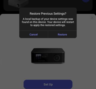

After resetting one of the Ultra units, this pop-up window appeared during the setup process.
I believe this is likely the restore feature the team mentioned here previously.
The current design lets you restore your device settings using the “Restore” button.
Our next step is to offer more granular control, including the ability to import and export your own settings files.
I may have overlooked this feature, but I can’t find any detailed documentation on it.

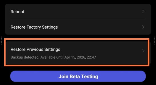

Currently, I assumed that to prevent data restoration, I would need to set up the device again after resetting it and cancel the restoration. However, I noticed that if I cancel the restoration, the "Restore Previous Settings" section appears on the device settings screen.
What should I do if I want to completely erase this restoration data?
(I don’t plan to give the device to anyone, but I just wanted to know.)
Thank you.
