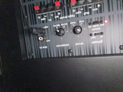

Sub crossover is set to max. See attached photo (apology for the quality)
Don’t know why the photo loads upside downs. Can’t help it. Sorry.
Current phase setting is 0 on sub and 180 WHA.
The sub is affordable (or simply: cheap) Mivoc Hype G2 sub.

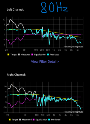

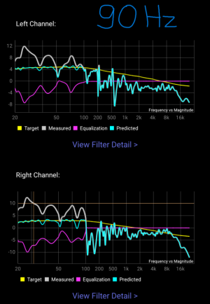

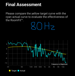

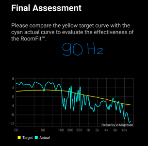

90 Hz looks better to me, both, individual channels and final assessment.I did what you recommended @dominikz, which is to move the speakers farther away from the side wall. I was able to do it and now the distance from the side wall is 104cm.
1st Test: Crossover at 80 Hz
2nd Test: Crossover at 90 Hz

Nice, good work!I did what you recommended @dominikz, which is to move the speakers farther away from the side wall. I was able to do it and now the distance from the side wall is 104cm.

I'm amazed on the result just by adjusting the speakers a few inches away from the side wall. I'm so thankful on you guys here! I will use the 90Hz crossover profile.Nice, good work!
We can see how with the placement change the left channel 80-100Hz dip improved (got a bit shallower), and then changing to a 90Hz crossover removed it completely.
The region around 50Hz looks a little bit rougher than what you had originally, but IMHO that's a reasonable tradeoff since it's not severe and anyway there's usually much more going on in music around 100Hz than 50Hz.
I'd say the 90Hz crossover with the new placement is the most promising one so far, but I agree with @harkpabst that all three variants you measured are pretty good and that you should choose the one that sounds best to you.
