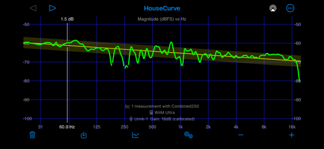

Speaker/sub placement is really critical, and needs to be optimized first for RoomFit to work well! This IMHO cannot be overstated. I provided some placement advice and explanations previously in this post.
I'd always recommend to use "Individual Channel RoomFit" instead of "Stereo RoomFit" when the option is presented.
RoomFit "No-Boost Mode" was released recently and I'd advise to enable that. In this mode good values to start are Min Gain: -12dB, Max Gain: +6dB, Max Q: 10.
Recently I also wrote this post, hope you might find it useful as well. Good luck!
If you have a UMIK-1 I'd definitely use that, regardless of the phone you use with it.
Just note that some phones were reported to underrepresent bass even with external mics connected (see this example). I don't believe there's any definitive list of devices that have this issue, though.
