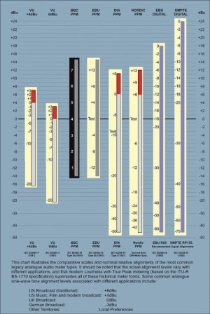

That is why some of us have tried to get WiiM to understand how you could actually create a analog VU meter design that could be useful in the digital domain.A digital peak meter had some usefulness but might be less pleasing to watch.
a true peak overload downstream of all digital processing would be useful...with referrals to Wiim Home for ALL Wiim products...WiiM didn't stop updating the "VU meters" again and again, so the topic is obviously still hot.
Personally I don't care much about these meters. But I musts confess that I find any attempt to create a "true" VU meter (which by very definition is an analogue device) completely pointless as long as the signal it's based on is in the digital domain. A digital peak meter had some usefulness but might be less pleasing to watch.
What is dB in this case? dBFS or dBvu?Hi Team,
Sorry for the delayed reply. Let me clarify how the current VU Meter works: it reflects the signal level after EQ processing (including pre-gain) but before the limiter.
We chose this design because many users prefer to monitor potential clipping in their system. Since the reading is taken before the limiter, the level can occasionally exceed 0 dB.
I hope this helps clarify. If you'd prefer to view the level after the limiter, we can consider adding an option to switch between the two display modes.

Hi hgo58,What is dB in this case? dBFS or dBvu?
Is it using 24 bit or 32 bit values?
I assume the description above is for the output. What about the original signal?
Thanks! Does the VU meter show peak level, or some kind of average level (and if so how is the average calculated)?We chose this design because many users prefer to monitor potential clipping in their system. Since the reading is taken before the limiter, the level can occasionally exceed 0 dB.
Good.Hi hgo58,
It's for the output and in dBFS (the digital audio signal is used for calculation). If the original signal is chosen, it never exceeds 0dB.
