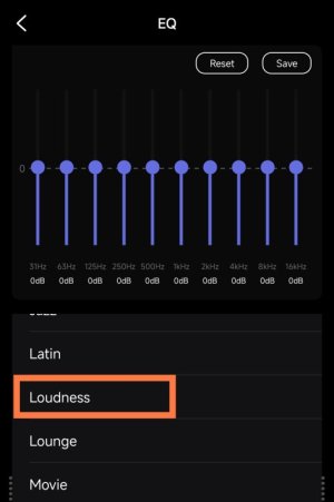

One of the GEQ settings is labelled "Loudness" isn't it?
If you're referring to the Echo, I only see Bass, Mid Range and Treble adjustments. I cannot find any reference to GEQ or loudness. Do you have a screenshot you can share please to point me in the right direction?
@harkpabst mentioned loudness in the WiiM app's preset custom EQ 🙂

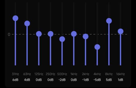

I tried the Loudness EQ in the WiiM Mini, but it didn't sound very good at all with the Echo speaker. I think it takes too much away. I have reverted to Rock which sounds the best to our ears.

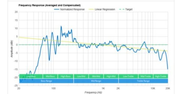

This is the frequency response of the Echo 4th gen by RTINGS. Based on this, it can be inferred that the Echo is bass-enhanced, but rolls off steeply below 60 Hz.
On the other hand, the loudness EQ on the WiiM tries to boost below 63 Hz, and the Echo may not have felt the sound was better because it can't reproduce this frequency range.
In my opinion, sound quality can be improved by adding a sub, setting the crossover to around 60 Hz and using RoomFit to compensate up to 200 Hz. If a high-pass filter is available, the crossover can be increased further.
