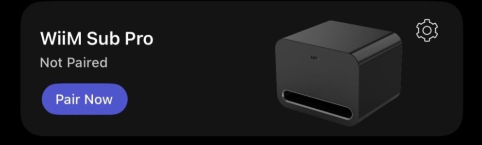

If I unpair mine, it is still connected by cable, and still works the same, but more options are available in the Subwoofer settings in the WiiM Home App.
In addition, I now get the annoying pop up notification to pair my Sub Pro.
