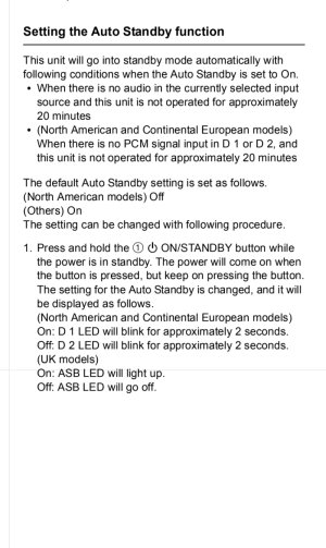

Attached is a screenshot from the manual relating to standby mode. The solution you’re looking for may be here.
Edit:
Attached full manual.

But how does auto stand-by help if there's no auto wake-up?
I don't know if the unit will auto wake or not, I didn’t dive in that far and I don't own one to test. The OP will have to make that determination.
Edit:
Upon review, the manual makes no mention of an auto wake function.
