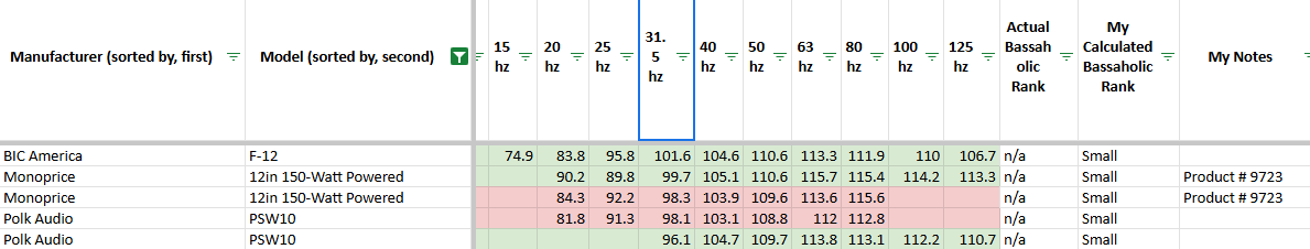

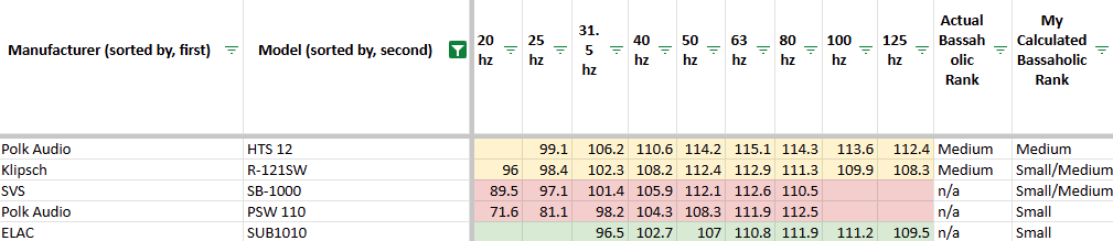

Note that from the CEA-2010 measurements we can see that ELAC SUB1010 isn't really the best performer (i.e. it doesn't have much output at low frequencies).
Here's a comparison of a few similarly priced models from the spreadsheet (with those having the most output at the top):
