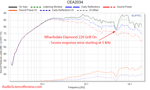

Absolutely add a subwoofer! I wondered about the bass response of your wharfdales so I searched and found this ASR Review suggesting that you do indeed need a subwoofer:
With your WiiM Ultra handling the crossover @ 80-100Hz to a subwoofer, you'll say "Wow. Wish I'd done this sooner!". Given your nice budget speakers, I'll recommend the SVS SB-1000 Pro subwoofer as a great value that others here suggested to me and I'm very pleased.
