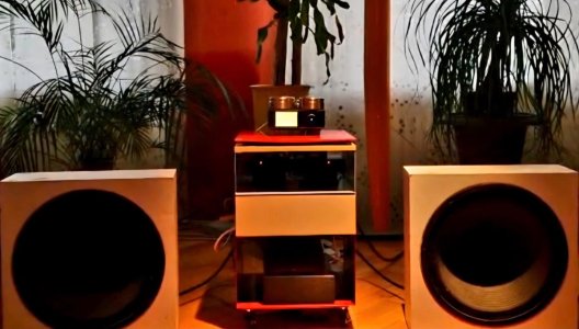

The WAU currently powers two main speakers (see appendix).
What surprised me was that it does not generate less waste heat with the large speakers. I can understand this with the "small" ones!
The large ones require hardly any power to generate a maximum of 65dB.
I'll go up to 80-85 dB at the listening position... significantly warmer than the other D-amps below it for the bass.
