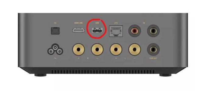

Hello,
the amp ultra has an USB port. Do you know for what it could be used ?
Would it be possible to use it for the power supply of a CD player like the Fiio DM13 which has an USB port for power supply ?

The USB port on the Amp Ultra is for media input and audio output. It can also supply power, but it is uncertain whether it can provide the current required for your CD player.

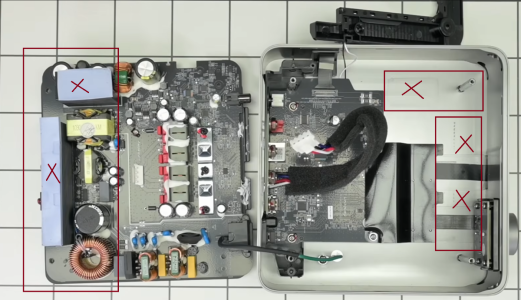

Do we know where the TMP102 is situated? Presumably close to the amplifier chips. I normally find the CPU temp is lower than the TMP102 temp on the Amp.
TMP102 is for the power supply.
The Power supply section have heat sink and thermal pads that touches the upper aluminium shelf.

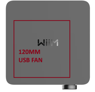

We can put a usb fan to further cool it as so.

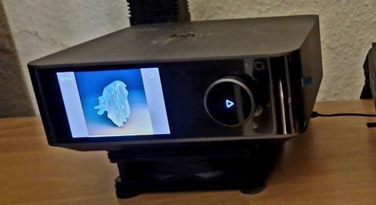

Fosi fan, because the WAU already gets warm when it has to power a speaker with 98dB.
