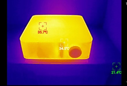

This is beyond ridiculous. The Amp Pro runs cool - I consider cool the top surface measuring 110F; yes that is cool. It is an amp, physics at play, efficiency can’t be 100%. Dwelling on this affects one’s mental state and prevents enjoying the device for its purpose — music playback!
WiiM's class D amps are computers with specialized audio ports. Nobody bats an eye at 110F / 43C on a fanless computer. We might complain about a hotspot on a laptop or desktop computer.

There’s a computer in the streamer driving a WiiM amp but… a class D amp is not a computer and it’s not even a digital circuit.
What you've mentioned is patently obvious, but irrelevant. A typical computer board produces more heat than a Class D amp. The SBC in the WiiM is probably producing 10-15W of thermal waste while the Class D amp is producing 1-3W (normal listening level) and higher with greater than typical amplification and even at max output is at most on par with the SBC. The SBC is much more likely to be the primary thermal source in the WiiM.
