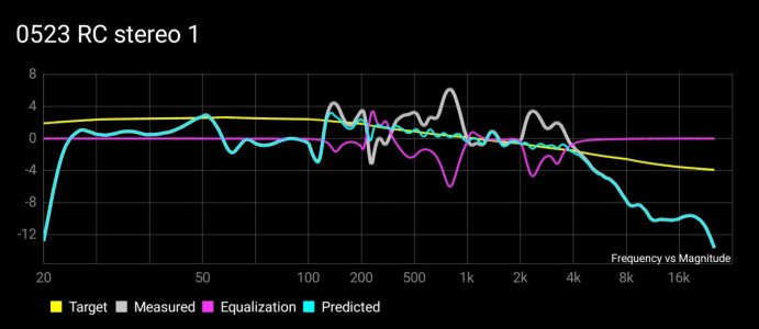

Anyway I'll put up the results of today's test...
[RC 1]

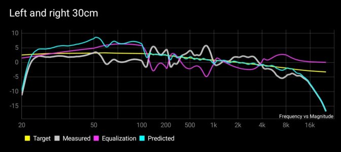

Slides 30 cm to the left and righta1ea6d94-21ca-43f7-8a91-88d9508dfe28-1_all_2073.jpg

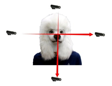

[RC 2] Spinning around the head
[RC 3]
Cross

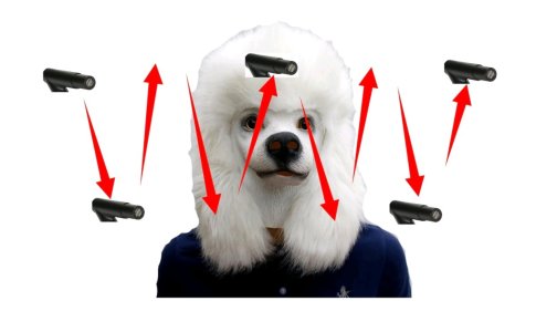

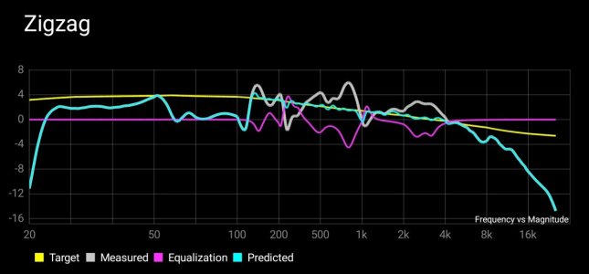

[RC 4]
Zigzag

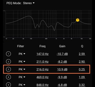

MMM off (Stereo RC)

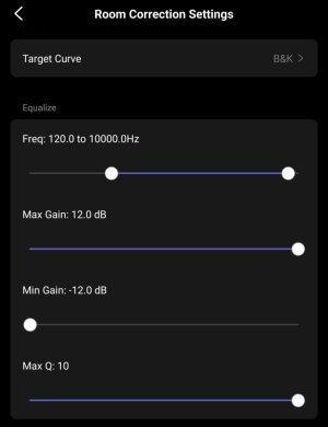

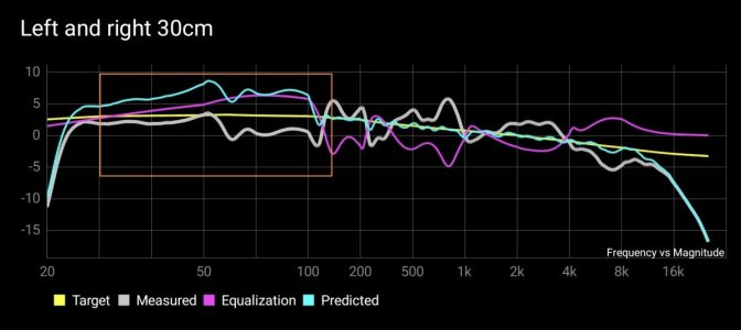

What was interesting was the result of the first measurement. The measurement range is 120hz-10khz, but WiiM tried to reinforce the bass by raising the 216hz by 10.9dB with Q0.25.
Only the first one is boosted, even though the other four RCs measured the same low frequencies. If I am not mistaken, I have never seen such a result before. (However, I have two subwoofers connected to other WiiM devices, so this error(?)could have occurred.)
Back on topic,
Naturally, the results will vary greatly depending on how the mic is moved, so I have no idea now how the mic should be moved 😂🎤.
Unfortunately there is no way of knowing what the mmm part of the process actually does.
As far as I can get from a lil' calibrated microphone (a simple IMM-6) , I noticed a filters Q management more relaxed.
This makes me suppose that a value integration is actually done, through a larger number of points achieved during the mic travel.
Of course, what happens under the hood and how the device manages those addictional readings is far from my reach.
