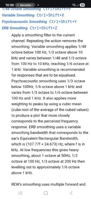

Finally managed to make some measurements today.
Let's compare Variable and 1/12 smoothing with both MMM and a single point sweep, all with correction range set to 20Hz to 300Hz (and all other setting equal):
As we can see above, all of these approaches result in similar "Equalization" curves and therefore the "Predicted" curves are similar as well. This is in line with expectation - at low frequencies all of these approaches are equally valid, so no big differences are expected.
One thing to note is the <30Hz response, where we can see a difference between sweep and MMM attempts. This is specific to my system - when using MMM RoomFit (incorrectly) assumes the response rolls of at 32Hz (because of the null there), and that the curve below it is environmental noise so doesn't correct it.
Now let's evaluate the RoomFit corrected responses with REW and MMM.
Here's how a RoomFit correction based on MMM 1/12 smoothing compares to the one made with Variable smoothing (single channel response shown):
No meaningful difference, at least not when the correction is limited to low frequencies only.
If using a just single point sweep instead of MMM again the results are pretty similar with either smoothing:
Lastly, let's compare MMM vs single point sweep when using variable smoothing for both:
Apart from the <30Hz difference (explained at the beginning of the post), the remaining differences are pretty small (but they are there). MMM is a bit smoother.
All in all, my conclusion is that variable smoothing works exactly as expected!
After all this people might ask why even bother if everything is so similar? My advice is to try and resist overthinking it. :D
Regarding measurement type:
  • If you don't have a lot of time and/or can't control environment noise use a single point sweep.
  • Otherwise MMM produces responses which are smoother and more similar to loudspeaker's anechoically Predicted In-Room (PIR) response. But do note that MMM is much more sensitive to noise and user-error than the single point sweep.
In both cases I'd personally always recommend using Variable smoothing - actually, I really don't see the need to use any other smoothing type for room correction purposes. Variable smoothing is precise in the bass (so it can fix sharp resonances), and smooth in the highs (which reduces the chance of overcorrection, especially when using a single sweep to measure).
