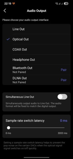

"Simultaneous Output (Beta): Supports Optical/Coaxial with Line Out for simultaneous playback. Enable it on the Audio Output page."
Is there a toggle switch on this? I don’t see it on my ultra with latest app.

The Simultaneous Line Out toggle is located on the Audio Output screen.

The Line-out outputs exactly the same signal as the digital-out.
So when a crossover is enabled, a high-pass filter is applied to the Line-out as well, so it can't be used as a Sub-out.

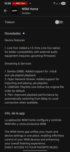

Got it also in Android.

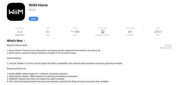

General Improvement section removed, the Device Features and Streaming the Services the same.
By the way, we are discussing 3.5.5 on a a 3.5.2 releasw update thread..and there's no other newer than this ...
