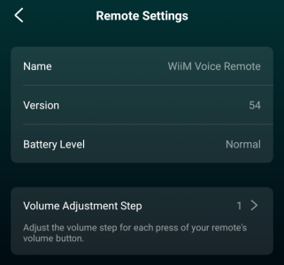

2. TV Remote: Adds an option to adjust the volume step for the TV remote (requires upcoming update).

for me its working with the newst firmware on the ultra - sounds better :)
  • AFCCEC0A-2D60-4B5F-867E-02975D0822BF_B1FB6400-EA21-4E34-922A-72C01DE4FE16.jpeg
