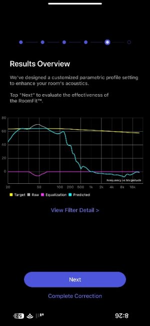

This is what my wiim sub pro frequency response looks like using my iPhone 15 mic. There’s a rolloff between say 50-100hz. My bookshelfs also start rolling off after 100hz. Hence the combined effect looks like a crossover drop.
I will try repositioning the sub and maybe rotating it to see if the perceived response changes.

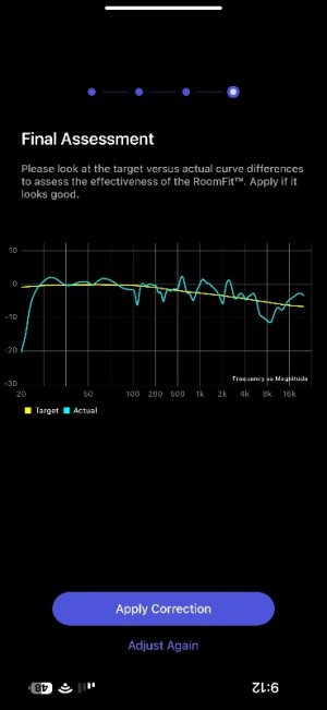

If you increase the Sub Pro volume and then use Ultra's RoomFit to correct frequencies between 30Hz and 300Hz, will it approach a flatter response? (with non-boost mode enabled)
