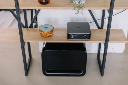

WiiM Sub Pro is Now Available on Amazon US

@RyanWithWiiM, can you please confirm that the WiiM Sub Pro is really a wireless subwoofer, not a 15" display? :unsure: ;):p:ROFLMAO:
