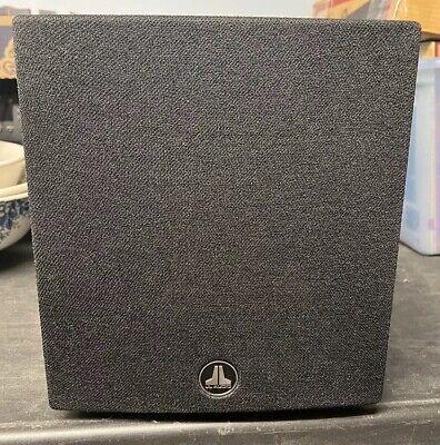

Looks like there is a good deal on ebay right now for a used one:

I found the following deal which has also a matching voltage for me.
Does anyone has experience with this platform Audiogon? Is it a safe place?
