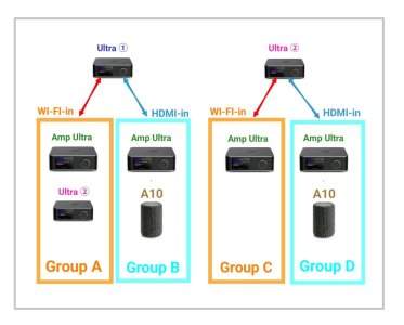

I had thought this was a feature with no practical use for me, but I've come up with one. It seems to hold tremendous potential as a function for switching group configurations.
What deserves attention is that it now allows switching the leader device, something previously impossible with persistent groups.
To verify whether my idea could be realised, I installed the beta version on two Ultra units and created two groups, one for the Wi-Fi input and one for the HDMI input on each Ultra.
For the WI-FI input on the "Ultra 1", create a group containing the Amp Ultra and the "Ultra 2".
For the HDMI input on the "Ultra 1", create a wireless Dolby group containing the Amp Ultra and the AudioPro A10.
For the Ultra 2 Wi-Fi input, create a group including the Amp Ultra.
For the Ultra 2 HDMI input, create a wireless Dolby group including the Amp Ultra and AudioPro A10.
When streaming music was first played on Ultra 1, Group A was automatically created on the WHA. Next, switching Ultra 1's input to HDMI caused Group A to be dissolved and Group B to be created.
Next, when streaming music was played on Ultra 2, Group C was formed with Ultra 2 as the leader. Subsequently, switching Ultra 2's input to HDMI changed the configuration to Group D. Finally, playing music again on Ultra 1 switched back to Group A. (In this video, it is switching from group D to group C.)
This is a screen recording of the sequence of actions.
View attachment aee25541-b87d-407e-b8ed-ef40c0880b0d-1_all_2166.mp4
Unfortunately, the initial group switch did not work smoothly at this stage, requiring several input switches and playback pauses. However, once this operates smoothly, it should significantly reduce the previously cumbersome effort involved in switching groups.
I have no way of knowing whether the @WiiM Team had given such uses much thought, but I suspect this feature could be further refined when used in conjunction with presets. Therefore, I would be delighted if group configuration options could be added to the presets. Furthermore, adding an option within presets to switch input twice could potentially make this automatic group switching even smoother.
For users who own multiple devices and operate multiple multi-room groups, I believe this holds the potential to be a fantastic feature.
