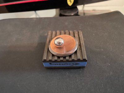

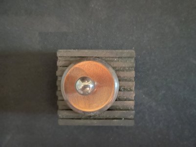

Yes, where previously had everything on the Grand Prix Monaco stand, everything was impacting and strangely even mid-fi solid state gear like a 200 watt Rotel amplifier.
Here, it was a diy effort. The WiiM Pro is a very lightweight device. Didn't expect any impact so was surprised there was. Applied the ball bearing floating concept. Drilled into the blue/black rubber type base and inserted the curved brass pieces. (Got those off Etsy I believe.) Then the ole 1/2" hard stainless steel ball.
Insert under any device using three of them in a triangle formation. Give a push and watch the short float movement. You're good to test!

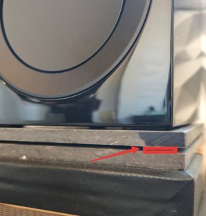

I use these gel pads in many places in my house. They are mainly for earthquake protection, but I also place them under speakers. However, if I place them directly under the speaker, the vibrations from the woofer could cause the cabinet to shake. So, I stack two stone slabs as a base, like this, and sandwich a gel pad between them.🙂

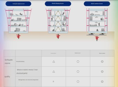

What's the difference between vibration damping and vibration dissipating?
Damping putty suppresses the vibration of materials. Seismic isolation (dissipating) gel pads make it difficult for vibrations to transmit to other materials.
This diagram shows how each component functions during an earthquake.
