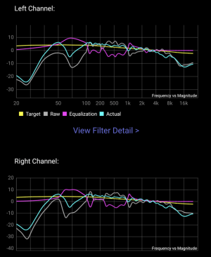

I managed to screenshot this when doing the no-sub run just now
Big hole at crossover point. you may want to play around with subwoofer position, use REW room sim to get an idea how sub response changes in the room

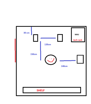

Am I understanding this right that both your speakers are practically in your room corners?
Are the speakers 30cm from the side walls, or from the wall behind them?
How wide is the room?
The subwoofer is in the corner, right?
This is my man cave, the wideness of room is not to dimension. I guess it is around 3.5x5m
hm what does hole at the crossover point caused by? I thought i have set according to wiim recommended settings

Sub placement, your position, and room shape and height effects that,
It's pretty complex to get it right (especially moreso if you have dual subs)
Try and get the speakers response (disable sub in wiim app) and see how it compares with the sub enabled. If speakers looks like they go lower with just the speakers, then the sub is cancelling <frequencies , so look into placement/delay

First, increase the Sub volume more before running RoomFit. After that, as @dominikz mentioned, try adjusting the crossover values, switching the phase, and adjusting the delay while checking the RoomFit results.
hmm cancelling out? does it mean i should lower the crossover some more, and let the speakers play lower?
More likely speaker placement since there was no sub involved in that measurement.

The issue is that your speakers are not giving much output between 70Hz and 100Hz. Try moving the speakers closer to the wall and repeat the measurement.
So this is measured with the sub output disabled?

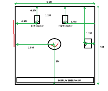

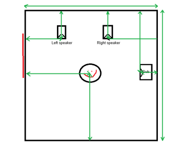

Unfortunately this diagram is missing a lot of the dimensions I need to be able to help.
These are the dimensions which would be helpful:
Thanks for the drawing, i have added some measurements i roughly took just now

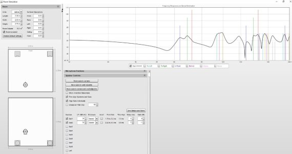

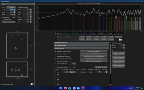

Here is predicted response with your room size and placement, probably need height of room, height of speakers as well.
Does it match up to yours?
