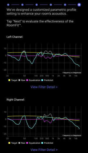

I guess there is resemblance, this was my roomfit reading without sub https://forum.wiimhome.com/threads/how-to-set-up-roomfit-correctly-help.8811/post-162214
It is the big dips at the 60-70hz range that is questioned. I wonder if that is my phone mic issue?

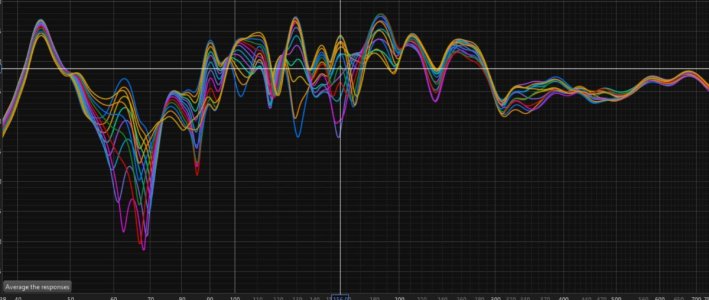

And here is what the different phase settings (what wiim shows as delay) for the sub, see how phase on the sub effects overall response. you can see some settings boost or cut certain frequencies along the range.
So with these responses I can compare each phase degree, enable/disable three, then see what is best, what is the flattest.
This is response with sub + left speaker

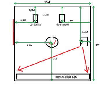

Thanks for the drawing, i have added some measurements i roughly took just now
Thanks, these are helpful.
Regarding the speaker distance to the wall behind them - I assume 30cm is the distance from the back side of the speaker to the wall - so if the LS50 speaker is 28cm deep, that gives a total of about 58cm from the front of the speaker to the wall behind the speaker.
In the calculation I assume the height of both speakers is about 1,2m (i.e. from floor to middle of speaker), that your head is at the same height when sitting at your listening position, and that your room is 2,5m high - let me know if any of this is incorrect.
If we plug these dimensions into this online SBIR calculator, we can see that with the current placement of speakers:
  • For the left speaker SBIR cancellations from the side wall is at roughly 85Hz, the ceiling SBIR notch should be about 65Hz, and floor SBIR notch about 70Hz.
  • For the right speaker SBIR cancellations from the side wall is at roughly 57Hz, the ceiling SBIR notch should be about 65Hz, and floor SBIR notch about 70Hz.
  • For the subwoofer SBIR cancellations from the front and back wall will overlap at around 45Hz.
  • At your listening position LBIR cancellations from 3 of the 4 walls will overlap at about 45Hz, the 4th wall LBIR notch will be at about 55Hz, while ceiling and floor LBIR notches would overlap with those from the speakers.

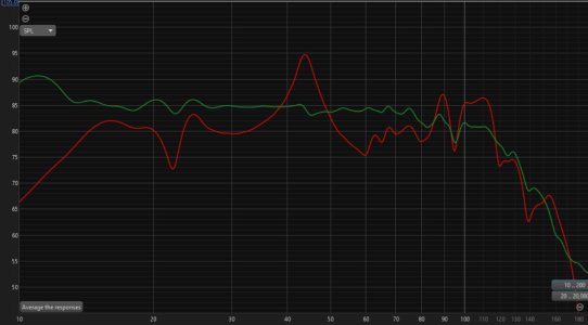

I managed to screenshot this when doing the no-sub run just now
They seem to match pretty well to the prediction for the speakers, so my assumption is that the cause of the wide dip/null around 70Hz in your measurements is caused by a combination of SBIR and LBIR at your current positions.
My proposal to improve the response would be to try this:
  1. Move the sub to a room corner (any corner will do)
    • That should completely move the SBIR cancellations >80Hz (out of the subwoofer operating range), and give you more bass headroom for RoomFit correction
  2. Move both speakers 15-20cm to the right
    • That should keep the side wall SBIR notch below 80Hz for both
  3. Set the subwoofer crossover frequency to 80Hz in WiiM Home App
  4. Move both speakers 20cm closer to the wall behind them
    • That will push the front wall SBIR notch >200Hz and allow you to sit away from room center
  5. Move your listening position anywhere outside of the exact middle of the room
Note that steps 1, 2 and 3 work together to avoid SBIR dips in the summed (loudspeaker + sub) response.
So if you don't follow all of the steps the results may be less effective.
yeah dead center of room is pretty bad place, good recommendation to move the chair, if I move my chair a foot or so that changes overall response. now 3/4

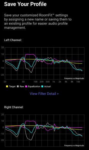

The dayton mic is in, use calibration file, and i am not seeing much of difference, same dips in 70-80hz. (name: same mic) :(
I tried the boost mode off with moving mic calibration, it truncated most EQ to only a narrow band (name: boost off)

Your issue is still the KEF LS50 seriously rolling off at 100Hz. Did you follow the suggestions in post #49?
I was hoping the mic would give a better reading since i just cant more my speakers around sadly. I have set them in place, the sub cannot go into a corner because of the rack and display shelf :(
Your issues seem to be acoustical and specifically related mainly to current speaker and sub placement - unfortunately they can't be solved by using a different mic, and even RoomFit can't fix them fully. The best solution would be to move them as suggested, but I understand how that can be problematic.
One thing you can try, however, is to set subwoofer crossover to 110Hz and then re-run RoomFit - just to see what happens to the dip.
Make sure to set volume to a resonable level before running RoomFit to avoid scary loud test tones. :)

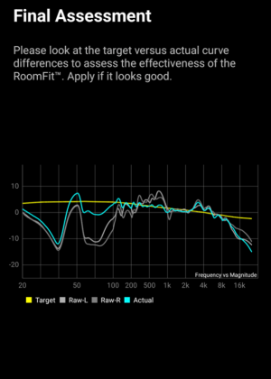

I just tried to push them back 15cm more, this is what i got. I think i am done playing with roomfit
Oh btw the new firmware with EQ spectrum display, i can see the how the test tones looks like on the WAU screen!
In that case try the 110Hz crossover frequency.

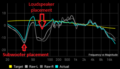

If you look again at post #49 you will see that pushing the speaker back won't solve the 70Hz dip. Also, as I said before, RoomFit alone can't solve the problem.
Let me try to illustrate again the causes of the two dips in your measurement:
The 70Hz dip would probably be improved by moving both your speakers 15-20cm towards the right side wall. Alternatively, it might go away if you increase the subwoofer crossover frequency significantly as I suggested in post #55.
At the moment we don't yet know if subwoofer and speaker sync (delay) and polarity/phase is optimal, so that may be a contributing factor as well.
The 40Hz dip would probably be solved by moving your sub to a room corner - even a corner behind you would work; and by avoiding listening from the center of the room.
